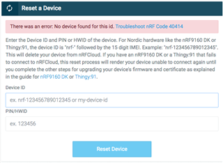

No device found for this id. Troubleshoot nRF Code 40414
I have a certificate attached, but in my personal account it gives an error when I enter the DK data.
Please tell me why the error occurs?
OS: macOS 10.13.6
Files:
  • nrf9160dk_asset_tracker_nbiot_2020-10-30_5522ca2b.hex
  • mfwnrf9160122.zip
  • I did all steps in your guide but your site https://nrfcloud.com/#/dashboard doesn't add my device.
    Please add my nrf9160 DK.

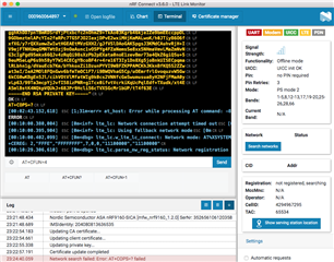

    AT+CFUN?
    +CFUN: 1
    OK
    AT+CGSN=1
    +CGSN: "352656106120358"
    OK
    AT+CGMI
    Nordic Semiconductor ASA
    OK
    AT+CGMM
    nRF9160-SICA
    OK
    AT+CGMR
    mfw_nrf9160_1.2.2
    OK
    AT+CEMODE?
    +CEMODE: 0
    OK
    AT%XCBAND=?
    %XCBAND: (1,2,3,4,5,8,12,13,17,19,20,25,26,28,66)
    OK
    AT+CMEE?
    +CMEE: 0
    OK
    AT+CMEE=1
    OK
    AT+CNEC?
    +CNEC: 0
    OK
    AT+CNEC=24
    OK
    AT+CGEREP?
    +CGEREP: 0,0
    OK
    AT+CGDCONT?
    OK
    AT+CGACT?
    OK
    AT+CGEREP=1
    OK
    AT+CIND=1,1,1
    OK
    AT+CEREG=5
    OK
    AT+CEREG?
    +CEREG: 5,4,"FFFE","FFFFFFFF",9,0,0,"00000000","00000000"
    OK
    AT%CESQ=1
    OK
    AT+CESQ
    +CESQ: 99,99,255,255,255,255
    OK
    AT%XSIM=1
    OK
    AT%XSIM?
    %XSIM: 1
    OK
    AT+CPIN?
    +CPIN: READY
    OK
    AT+CPINR="SIM PIN"
    +CPINR: "SIM PIN",3
    OK
    AT+CIMI
    204080813636535
    OK

    [0m<inf> asset_tracker: Connecting to LTE network.
    [0m
    [00:00:00.329,528]
    [0m<inf> asset_tracker: This may take several minutes.
    [0m
    AT+CFUN=4
    +CEREG: 0,"FFFE","FFFFFFFF",9,0,0,"11100000","11100000"
    [00:00:21.215,637]
    [0m<inf> asset_tracker: LTE cell changed: Cell ID: -1, Tracking area: 65534
    [0m
    [00:00:21.224,578]
    [0m<inf> asset_tracker: PSM parameter update: TAU: -1, Active time: -1
    [0m
    OK
    AT+CFUN?
    +CFUN: 4
    OK

    The device must be connected to nRF Cloud before you can add it to your account.
    On a nRF9160DK, LED 3 & 4 will blink together when the device is ready to be added.
    Also, the log from the device should say something like "Waiting for cloud association", although it might not be on the last line in the log.
    Was the device connected to nRF Cloud when you tried to add it to your account?
    Didrik
    The device doesn't connect for some reason to nRF Cloud. Please add it to my account.
    LED 3 & 4 doesn't blink.
    LED 1 & 2 blink together until I insert the SIM. After that, only LED 3 blinks.
    I haven't seen "Waiting for cloud association" yet.
    No, it wasn't.
    Vitaliy
     The SIM needs to be inserted for the application to work correctly.
    When only LED 3 blinks, that means that the device is searching for a network to connect to: https://developer.nordicsemi.com/nRF_Connect_SDK/doc/1.4.0/nrf/applications/asset_tracker/README.html#user-interface
    What SIM card are you using?
    Are there LTE-M or NB-IoT coverage in your area (and where is that)?
    Has the SIM card been activated, and does it support your local LTE-M or NB-IoT network?
    If you are running the default application that came programmed on the chip, or an unmodified version of the asset_tracker, it will try to connect to LTE-M.
    If there is only NB-IoT coverage in our area, you might want to try the *_nbiot_* or *_nbiot_legacy_pco_* pre-compiled .hex files from our website: https://www.nordicsemi.com/Software-and-tools/Development-Kits/nRF9160-DK/Download#infotabs
    If you do not use an application compiled with the "correct" network mode, you will have to wait 10 minutes before the network search times out and it tries the other mode.
    Finally, could you send me the log from the application?
    That way, I can see if the device finds any networks, but get rejected, or if it doesn't find any.
  • Dear Didrik,
    Thanks for the info.
    I use iBasis, which is bundled with DK. Today I learned from an iBasis representative that their SIM does not support LTE-M and NB-IoT networks in my country.
    I'll try to find a SIM that supports IoT and try again with a connection to the nRF Cloud.
