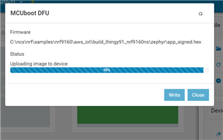

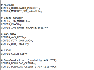

I'm evaluating Thingy:91 (nRF9160) and I was able to download asset_tracker application using MCUboot DFU without problems. Everything fine.
Now, I wanted to try the AWS_IOT sample but downloading the app_signed.hex file, and being almost done, the programmer throws an error:
"Image upload failed. Bad response from device." and it seems the device gets out of MCUboot mode, so I can't complete the device programming.
Please see screenshots below...
Any idea what could be wrong?
Thanks
