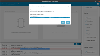

I am not able to update the modem firmware over usb/mcboot with the programmer on my Thingy91. I have tried both on linux and win 10, the problem is the same. The update process starts but hangs after "step 1":
The device continues to work after this. However, I can programm the hex applications for both mcus correctly. Currently I have modem firmware version 1.1.1 which seems to work, but I'd like to have a working upgrade path.
From what I could find on this forum, the modem firmware can not be flashed with mcumgr. So what to do? I have one of the edu mini J-Links which works great for programming and the RTT console, but I don't know if it could be used for updating the modem firmware. Any hints?
Kind regards, Claus

    If you uncheck the "Enabel MCUBoot" checkbox, are you able to select your J-Link and update the modem that way?

  • Dear Didrik, thanks for your fast answer!
    I could program the modem firmware with the j-link without problems! I didn't know I just needed to deselect MCUBoot. The edu mini is a great little interface!
    I am not sure where to check the hardware version, the protocol says NRF9160_xxAA_REV2 and the sticker on the board 1.4.0 and 2020.24.
    Though I am happy with the update process over the j-link, I could try to program the unit again with USB/MCUBoot to check if the error persists if you'd like.
