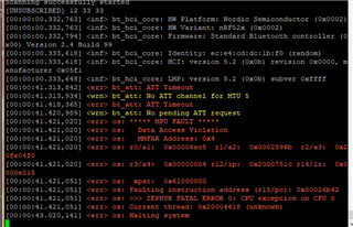

So I wrote one to implement it. The goal I want to achieve is one central to 30 peripherals
The current connection with 4 peripherals is fully stable, but when I increase the connected peripherals, the following error will appear
<err> bt_attLATT Timeout
<wrn> bt_att: No ATT channel for MTU 5
<wrn> bt_att: No pending ATT request
The picture below shows the error when connecting 20 peripherals
At present, I know that modifying the Interval connection will indeed improve, but only to make <err> bt_attLATT Timeout happen later.
How can I avoid this problem so that I can connect 30 peripherals stably?

  • Hi Hmw,
    Could you describe a little bit more about your application ?
    What's the connection interval you used ? What data do you send/receive , which direction ?
    You actually got a MPU fault, suggesting there could be a stack overflow. Please try increasing this: CONFIG_BT_RX_STACK_SIZE. Try double the stack size, maybe to 4096.
    Also, try to increase these if it's already as follow:
    CONFIG_SYSTEM_WORKQUEUE_STACK_SIZE=4096
    CONFIG_MAIN_STACK_SIZE=2048
    Are you using Zephyr stack or Nordic stack ?

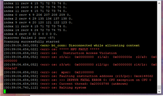

  • Hello
    I modified the following parameters to
    CONFIG_MAIN_STACK_SIZE=4096
    CONFIG_BT_RX_STACK_SIZE=4096
    Then an error appeared, as shown in the figure below. What is the cause of this?
    <wrn> bt_conn: Disconnected while allocating context
    After trying to change these three parameters to 8192, the above error did not appear.

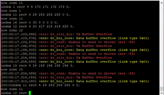

    CONFIG_SYSTEM_WORKQUEUE_STACK_SIZE=8192
    CONFIG_MAIN_STACK_SIZE=8192
    CONFIG_BT_RX_STACK_SIZE=8192
    But there is a Tx Buffer Overflow error, as shown below
    [00:36:55.371,032] <err> bt_ctlr_hci: Tx Buffer Overflow
    [00:36:55.371,063] <wrn> bt_hci_core: Data buffer overflow (link type 0x01)
    [00:36:55.371,063] <err> bt_conn: Unable to send to driver (err -55)
    However, it didn’t stop my data transmission, but it looks like it’s not right
    For my TX Buffer related settings, I set the official maximum value, as follows
    CONFIG_BT_CONN_TX_MAX=18
    CONFIG_BT_L2CAP_TX_BUF_COUNT=18
    CONFIG_BT_CTLR_RX_BUFFERS=18
    CONFIG_BT_CTLR_TX_BUFFERS=18
    CONFIG_BT_L2CAP_TX_MTU=247
    CONFIG_BT_L2CAP_RX_MTU=247
    CONFIG_BT_CTLR_TX_BUFFER_SIZE=251
    CONFIG_BT_CTLR_DATA_LENGTH_MAX=251
    CONFIG_BT_RX_BUF_LEN=258
    How can I modify it to prevent the Data buffer overflow error from happening again?
    Thanks.
    Poyi

    Is there any good solution to the Tx Buffer Overflow error mentioned above?
    Or is it related to my CONFIG_SYSTEM_WORKQUEUE_STACK_SIZE and CONFIG_BT_RX_STACK_SIZE?

  • Hello
    I don't quite understand what you mean
    you may pass the number of 18 tx buffer .
    It is true that my problem is very similar to it, but no one has provided a good solution yet, which troubles me a lot.
    The problem now is that I keep sending, and Tx Buffer Overflow will appear in the central after a while.
    When this error occurs, my central will continue to send data, but some peripherals will not receive the bt_gatt_write_without_response sent by central, but they will still stay connected to central
    In this case, it seems that there is no clear solution
    Is 500ms your estimated value, or is there an algorithm?
    I will try to look at 500ms and 1s, but in my situation, if I can transmit and receive data as quickly as possible, the better
