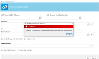

File -> Open nRF Connect SDK Project... then choose Cmake file of these path C:\Users\julio\ncs\v1.4.0\zephyr\samples\basic\blinky_pwm

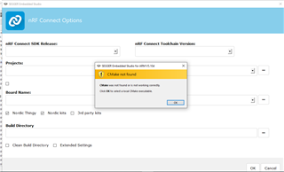

But it shows me script error.

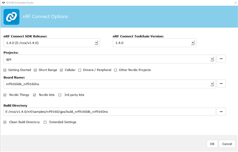

    I don't know what configurations you chose when opening the project, but for the nRF9160 DK you must remember to choose non-secure when you're building samples that run in the non-secure domain (you can read more about secure vs non-secure here if you're interested). By that, I mean that you have to choose "nrf9160dk_nrf9160ns" as your build target, with "ns" for non-secure. Below you can see a picture of how to open the project:

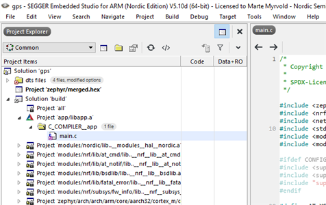

    After you've opened the project in SES, you can see the main.c file by opening "Solution 'build'" -> "Project 'app/libapp.a'" -> "C_COMPILER__app" in the project window on the left side, see picture below:

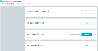

    Thank you very much for response quickly, now its working! I doesn’t have installed the Cmake, that’s was the problem, and I already have run gps example without problems, your answer was very useful to me, thank you.
