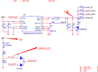

Our customer is using nrf9160.There is a problem about powem_on circuit .
Attach is the schematic diagram:
Here VBAT is 4V,PW_ON is connecting to the nrf9160 p0.27 pin.
As the bleeder circuit shows,when SW2 push ,PW_ON voltage should be 4*100/139 ≈ 2.8V,this will enable the power_ic to output 3.3V voltage
to make the system power on .
However when PW_ON connecte to P0.27,the PW_ON voltage come to 1V which couldn't enable the power_ic.
I think this is probably because the resistance in parallel is causing the voltage divider to work abnormally,so I connect a 100K resistance between PW_ON
and P0.27 pin , and it works fine.
I want to know which status the nrf9160 gpio in before system power on ? In this case ,should we only to change the bleeder circuit resistance value ?
