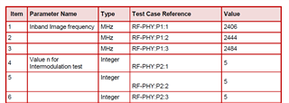

Hi, I'm about to perform an RF-PHY test on a module using nRF8001 to get a QDID. In that connection, I would like to know the specifications of the nRF8001.Can you tell me about the "?" Below?
IXIT Reference Identifier Sub-Ientifier
Value
Units
RF-PHY:P1:1 Inband Image frequency Low frequency ? MHz
RF-PHY:P1:2 Middle frequency ? MHz
RF-PHY:P1:3 High frequency ? MHz
RF-PHY:P2:1 Value n for Intermodulation test Low frequency ? Integer
RF-PHY:P2:2 Middle frequency ? Integer
RF-PHY:P2:3 High frequency ? Integer

  • Most if this doesn't apply for the nRF8001 as it doesn't support 2 Mbps, coded phy or constant tone extension. So everything from RF-PHY:P9:3 to the end is not applicable for the nRF8001. The nRG8001 only supports BLE4.0.
    This should be what you're after:
