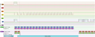

The return code shows that it was "successful." However, the serial write is not working properly. Here is what I measure using a logic analyzer on the serial transmission pin:
This is showing the 0xAA gets sent properly, but then the line goes low, and the rest of the sequence fails to transmit.
What is happening??

    EDIT:
      Thanks to you both for your help! After more investigation, I have figured out what is causing the problem, but I do not know how to solve it, and I am hoping you might have some ideas.
    In the screenshot below, TE is transmit enable, TX is the GPIO pin controlled by nrf_serial_write(), and A is the serial bus.
    The problem seems to be that TE (transmit enable) does not go high for long enough. I turn TE off when I get a NRF_SERIAL_EVENT_TX_DONE event. From the answer here, I thought that the NRF_SERIAL_EVENT_TX_DONE occurs only after the whole message is transmitted. But based on my capture below, it looks like I get a NRF_SERIAL_EVENT_TX_DONE after the first byte.
    Do you have any suggestions to make sure that the Transmit_Enable goes high for the whole transmission, and turns off only after the transmission is done? Maybe is there a different event that occurs after the entire buffer is empty and has been transmitted over UART? Thanks!
  • Hi
    The TX_DONE event basically happens after every transmitted byte. When using the older UART peripheral there is no buffering happening in the UART peripheral itself, this is all handled by the driver.
    If you want a callback when the TX buffer in the driver is empty I think you will need to change the nrf_serial.c implementation itself.
    If you look at how NRF_DRV_UART_EVT_TX_DONE is handled you will see that it polls the TX queue to see if there are more bytes to send, and breaks otherwise:
    case NRF_DRV_UART_EVT_TX_DONE:
        nrf_queue_t const * p_txq =
                p_serial->p_ctx->p_config->p_queues->p_txq;
        nrf_serial_buffers_t const * p_buffs =
                p_serial->p_ctx->p_config->p_buffers;
        event_handler(p_serial, NRF_SERIAL_EVENT_TX_DONE);
        size_t len = nrf_queue_out(p_txq, p_buffs->p_txb, p_buffs->tx_size);
        if (len == 0)
        ret = nrf_drv_uart_tx(&p_serial->instance, p_buffs->p_txb, len);
        ASSERT(ret == NRF_SUCCESS);
    You will also note that the application event is triggered for every byte, by this call:
    By moving this call into the if (len == 0) check you should change the driver to only call the TX_DONE event when all the bytes are sent, which sounds like what you need.
    Best regards
    Torbjørn
