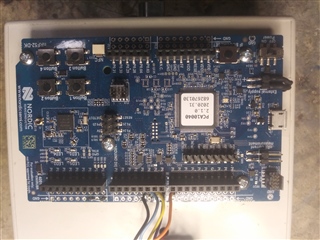

  • I am using J-Link version 6.88a.  Here is the screen shot of the error and the log when trying to connect to a Nordic nRF52-DK
    2021-01-06T14:48:39.269Z INFO Application data folder: C:\Users\jrohde\AppData\Roaming\nrfconnect\pc-nrfconnect-programmer
    2021-01-06T14:48:39.387Z DEBUG App pc-nrfconnect-programmer v1.4.8 official
    2021-01-06T14:48:39.387Z DEBUG App path: C:\Users\jrohde\.nrfconnect-apps\node_modules\pc-nrfconnect-programmer
    2021-01-06T14:48:39.388Z DEBUG nRFConnect 3.6.1 is supported by the app (^3.6.0)
    2021-01-06T14:48:39.388Z DEBUG nRFConnect path: C:\Users\jrohde\AppData\Local\Programs\nrfconnect\resources\app.asar
    2021-01-06T14:48:39.388Z DEBUG HomeDir: C:\Users\jrohde
    2021-01-06T14:48:39.388Z DEBUG TmpDir: C:\Users\jrohde\AppData\Local\Temp
    2021-01-06T14:48:39.401Z INFO Using nrfjprog library 10.12.1, pc-nrfjprog-js 1.7.6
    2021-01-06T14:48:40.274Z VERBOSE Could not fetch serial number for serial port at COM13
    2021-01-06T14:48:50.317Z ERROR Unsupported device. The detected device could not be recognized as neither JLink device nor Nordic USB device.
  • Correction on my original post.  I originally said that both the nRF52-DK and the Segger J-Link Base hardware show up on the "Select Device" pull down menu.  That is incorrect.  Only the nRF52-DK shows up on the "Select Device" menu.
