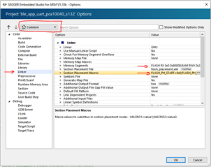

    What changes did you do in the flash_placement.xml, and why? Please note that adding white spaces may corrupt this file.
    Did you also do the same changes in your project settings? There are a few places in the Linker section that you need to change this in SES (Segger Embedded Studio), such as:
    • Linker -> Memory Segments
    • Linker -> Section Placement Macros
    Please remember to set the selection to "Common" before changing these:
    And why do you need to change the memory settings? Did you see the same issues before doing the changes? Did you try to use SDK17.0.0, which the github repository says that the example is made in/for?
