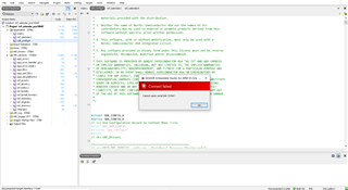

  •  To compile it, clone the repository in the [SDK]/examples/peripheral/ folder in SDK v16.0.0.
    I just did the same as you said but got the error
    Building ‘nrf_calendar_pca10040’ from solution ‘nrf_calendar_pca10040’ in configuration ‘Release’
    Linking nrf_calendar_pca10040.elf
    "C:/Program Files/SEGGER/SEGGER Embedded Studio for ARM 5.32a/gcc/arm-none-eabi/bin/ld" -X --omagic -eReset_Handler --defsym=__do_debug_operation=__do_debug_operation_mempoll -EL --defsym=__vfprintf=__vfprintf_long --defsym=__vfscanf=__vfscanf_long --gc-sections -TC:/nrf_sdk/nRF5SDK16/examples/peripheral/nrf5-calendar-example-master/pca10040/blank/ses/Output/Release/Obj/nrf_calendar_pca10040/nrf_calendar_pca10040.ld -Map Output/Release/Exe/nrf_calendar_pca10040.map -u_vectors -o Output/Release/Exe/nrf_calendar_pca10040.elf --emit-relocs --start-group @C:/nrf_sdk/nRF5SDK16/examples/peripheral/nrf5-calendar-example-master/pca10040/blank/ses/Output/Release/Obj/nrf_calendar_pca10040/nrf_calendar_pca10040.ind --end-group
    Output/Release/Obj/nrf_calendar_pca10040/ses_startup_nrf_common.o: in function `InitializeUserMemorySections':
    undefined reference to `__RAM1_segment_end__'
    Build failed

  • clone the repository in the [SDK]/examples/peripheral/ folder in SDK v16.0.0.
    I think that should be:  [SDK]\examples\ble_peripheral
    Which then gives me an SES Project "nrf_calendar_pca10040.emProject" in:
    [SDK]\examples\ble_peripheral\nrf5-calendar-example-master\pca10040\blank\ses
    If I open that, and do Build > Rebuild within SES - it builds successfully.
