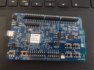

I have just started learning nrf. I have an nrf52832 board and I want to get and set time using app.
