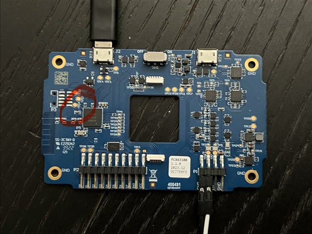

    Disconnect all other nordic devices from the computer, turn off the kit and remove it from the plastic by removing the four screws. Insert USB to J2 (USB DATA/POWER). Short a connection between GND (e.g on the four pin power output header) to TP34 on the PPK2. While holding the jumper cable, turn the kit on and remove the jumper. Now the PPK2 should be in bootloader again.

  • I've had to do this more than once, and each time, I'm hunting around the board for TP34.
    This is for my future self when I make the next mistake, and anyone else who finds it useful!
    For GND is easiest to use one of the screw holes.
