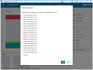

I could program the devkit as a client by adding the root of the example in the Global Macros.
I saw the devkit in the nrf Mesh application as nrf mesh switch.
After which, I followed the instruction suggested in this link to program the dongle board as a server.
I used the hex file built in the build folder in the server folder to program the dongle through nrf connect software.
after witting the hex file, these messages appeared.

What about the soft device code ID?
During programing, the NRF connect software required the soft device code ID. I used S140_nrf52_7.2.0. so I entered 0x0100 code, which I found in the devezone.nordic for the soft device.
was that wrong?

HI Sama,
I don't really understand why you need the softdevice ID ?
Just select the softdevice you plan to use and click write.

Hi Hung,
This is the stage which the NRF connect software needs the softdevice ID I am using.
As you can see there is not the s140_nrf52_7.2.0 version in the list and I have to enter the softdevice ID.
I used the 0x0100 code in this stage and I think that was wrong.
I would appreciate if you can advice me on the hex ID of the softdevice.

Hi Hung,
Thank you for your reply.
I found my mistake. Actually I did not load the softdevice correctly through the dfu folder.
