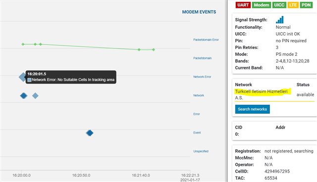

I am having trouble establishing a network connection with NRF9160 Dk. I use a local SIM and according to the information I got from the provider, there is no problem with my card but my device is "undefined" in the network. I also did not manage to establish a connection with iBASIS too.
When I received the development card, I firsty full erase the chip via nRFConnect Programmer and then upload asset tracker application...
I read such an info:
"If you carelessly erase the entire flash inside the nRF91, you would lose the key that cause failure to link to the network."
More:
that link
May it cause problem to link to network ?
screenshot:
my log:
 failed: phone failure

    Okay, this is what I can see from the log file you attached.
    First off, you intend to use NB-IoT, correct?
    Line 102: +CNEC_EMM: 15
    Line 107: +CEREG: 4,"FFFE","FFFFFFFF",9,0,15,"11100000","11100000"
    EPS mobility management error 15 and <reject_cause> 15 in the +CEREG response indicate the same thing
    No suitable cells in tracking area.
    This EMM cause is sent to the UE if it requests service, or if the network initiates a detach request, in a tracking area where the UE, by subscription, is not allowed to operate, but when it should find another allowed tracking area or location area in the same PLMN or an equivalent PLMN.
    From the log it looks like you're only giving it 7 minutes, is this correct?
    Could you try it for a little longer so the UE has time to search all available cells in your area?

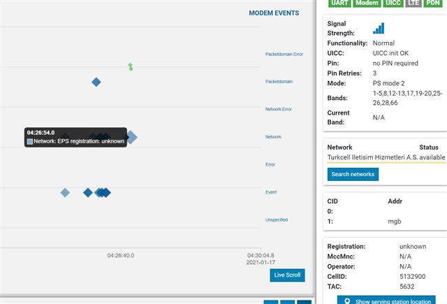

    Sorry for the delay, I ordered new nRF9160 DK and a Nordic Thingy 91 for testing... for both TURCELL and iBASIS Sim Cards, the results are same like before. I also tested the devices in my home and in my office. (open field, clear area, center of Istanbul).
    As you recommend, i waited longer (more then 3 hours) to let UE seacrh all available cells in the area but the results is same - " no suitable cells in tracking area". But i realized that despite the "timeout" warning in the terminal, the modem continues searching and finds the network( Turkcell Iletisim Hizmetleri A.S. ) but still no registeration... ( we actaully knew it from the logs but now NRF connect shows it in the GUI.)
    The results are same for whole:
    for LTE M --> no signal strength, no network, always searching
    for NBiot --> full signal strength, Network is TURKCELL, no suitable cells and EPS registeration unknown. (for iBASIS too)

    2021-01-17T13:20:01.353Z DEBUG modem << [00:09:05.306,854] [0m<dbg> lte_lc.parse_nw_reg_status: Network registration status: 2[0m
    2021-01-17T13:20:01.571Z DEBUG modem << +CNEC_EMM: 15
    2021-01-17T13:20:01.677Z DEBUG modem << [00:09:05.605,895] [1;31m<err> lte_lc: Could not parse AT+CEREG response, error: -11[0m
    2021-01-17T13:20:01.680Z DEBUG modem << [00:09:05.613,922] [1;31m<err> lte_lc: Could not get network registration status[0m
    2021-01-17T13:20:01.682Z DEBUG modem << +CEREG: 4,"1600","004E5264",9,0,15,"11100000","11100000"
    2021-01-17T13:20:01.724Z DEBUG modem << [00:09:05.626,922] [0m<dbg> lte_lc.parse_nw_reg_status: Network registration status: 4[0m
    2021-01-17T13:20:02.343Z DEBUG modem << %CESQ: 255,0,255,0
    2021-01-17T13:20:02.454Z DEBUG modem << +CEREG: 4,"FFFE","FFFFFFFF",9,0,15,"11100000","11100000"
    2021-01-17T13:20:02.463Z DEBUG modem << [00:09:06.398,132] [0m<dbg> lte_lc.parse_nw_reg_status: Network registration status: 4[0m
    2021-01-17T13:20:11.488Z DEBUG modem << %CESQ: 84,4,21,3
    2021-01-17T13:20:11.592Z DEBUG modem << +CEREG: 4,"1600","004E5264",9,0,15,"11100000","11100000"
    2021-01-17T13:20:11.602Z DEBUG modem << [00:09:15.544,982] [0m<dbg> lte_lc.parse_nw_reg_status: Network registration status: 4[0m
    2021-01-17T13:20:15.952Z DEBUG modem << %CESQ: 84,4,26,3
    2021-01-17T13:20:56.316Z DEBUG modem << [00:10:00.372,741] [0m<inf> lte_lc: Network connection attempt timed out[0m
    2021-01-17T13:20:56.417Z DEBUG modem << %CESQ: 255,0,255,0
    2021-01-17T13:20:56.428Z DEBUG modem << %XSIM: 0
    2021-01-17T13:20:56.534Z DEBUG modem << [00:10:00.404,266] [0m<inf> lte_lc: Using fallback network mode[0m
    2021-01-17T13:20:56.536Z DEBUG modem << [00:10:00.410,400] [0m<dbg> lte_lc.w_lte_lc_connect: Network mode: AT%XSYSTEMMODE=0,1,1,0[0m
    2021-01-17T13:20:57.342Z DEBUG modem << %XSIM: 1
    2021-01-17T13:20:57.457Z DEBUG modem >> AT+CPIN?
    2021-01-17T13:20:57.534Z DEBUG modem << +CPIN: READY
    2021-01-17T13:20:57.537Z DEBUG modem << OK
    2021-01-17T13:20:57.547Z DEBUG modem >> AT+CPINR="SIM PIN"
    2021-01-17T13:20:57.626Z DEBUG modem << +CPINR: "SIM PIN",3
    2021-01-17T13:20:57.629Z DEBUG modem << OK
    2021-01-17T13:20:57.712Z DEBUG modem >> AT+CIMI
    2021-01-17T13:20:57.789Z DEBUG modem << 204080813558508
    2021-01-17T13:20:57.792Z DEBUG modem << OK
    2021-01-17T13:20:57.795Z INFO IMSIdentity: 204080813558508
    2021-01-17T13:21:38.516Z DEBUG modem << %CESQ: 80,4,22,3
    2021-01-17T13:21:50.675Z DEBUG modem << %CESQ: 80,4,27,3
    2021-01-17T13:30:56.424Z DEBUG modem << [00:20:00.453,002] [0m<inf> lte_lc: Network connection attempt timed out[0m
    2021-01-17T13:30:56.445Z DEBUG modem << [00:20:00.459,991] [1;31m<err> asset_tracker: LTE link could not be established.[0m

    2021-01-17T13:31:44.132Z DEBUG modem << +CEREG: 2,"FFFE","FFFFFFFF",7,0,0,"11100000","11100000"
    2021-01-17T13:31:44.262Z DEBUG modem << [00:00:47.018,035] [0m<dbg> lte_lc.parse_nw_reg_status: Network registration status: 2[0m
    2021-01-17T13:40:57.505Z DEBUG modem << [00:10:00.375,854] [0m<inf> lte_lc: Network connection attempt timed out[0m
    2021-01-17T13:40:57.554Z DEBUG modem << +CEREG: 0,"FFFE","FFFFFFFF",7,0,0,"11100000","11100000"
    2021-01-17T13:40:57.578Z DEBUG modem << [00:10:00.399,230] [0m<dbg> lte_lc.parse_nw_reg_status: Network registration status: 0[0m
    2021-01-17T13:40:57.583Z DEBUG modem << [00:10:00.407,623] [0m<inf> lte_lc: Using fallback network mode[0m
    2021-01-17T13:40:57.586Z DEBUG modem << [00:10:00.413,757] [0m<dbg> lte_lc.w_lte_lc_connect: Network mode: AT%XSYSTEMMODE=0,1,1,0[0m
    I do not make any changes on the examples, do i miss something?
    Hamit
  • It looks like both devices are finding the same one cell with TAC 1600 and CI: 004E5264 for NB-IoT, which you say is Turkcell Iletisim Hizmetleri A.S? Have you gotten this confirmed?
    If Turkcell provided you with the SIM you are using, you should talk to them. Perhaps you have the wrong subscription, or the SIM card only supports LTE-M, while the cell is NB-IoT, so the attachment request gets rejected.
    Have you confirmed with the network provider that the SIM cards you are using support NB-IoT?
    This might not be an issue, but I see both devices have an old MFW version. I recommend you upgrade to MFW version 1.2.3 on both of them. Have you updated to the latest available application firmware? If not, I recommend you do that as well.
    If you are able to take a modem trace when the device is trying to connect, please do that and send me the file. This will help speed up the debugging process.
    Heidi
