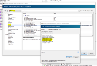

    It looks like the application.hex has been linked with the wrong start address in flash based on the error you are getting from mergehex. Please go over the linker settings and make sure the start address have been set to 0x23000 like in the other SDK BLE examples.
    Memory layout configuration settings if you're using the Segger embedded studio IDE

    The memory layout you posted is probably for a newer version of the s132. s132 v5.0.0 goes up to address 0x23000 as shown in the image I posted (you can also find the Softdevice size from the Softdevice release notes)
    In my application I am not using BLE Related Task , That is just Simple Example like UART and all. so For that also i have to give 0x23000 Location while Building ?
    It must start at 0x23000 if you are going to program it toghether with the s132 v5.
