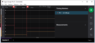

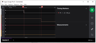

  • If the main problem is that the interrupt handler in the GPIOTE driver uses a long time before it calls your event handler, I think it would be better to implement your own simplified driver and remove the the nrfx_gpiote implementation from your project (unless you need this for something else in the application).
    I'm not sure about your configuration of GPIOTE, but you may also speedup the event handler if you use IN-EVENTS (high_accuacy = true), and not PORT-EVENTS. IN events are mapped to a specific pin, while multiple GPIOs can trigger a PORT event. For PORT event, the handler needs to read all enabled PINs in order to detect which pin triggered the interrupt. The GPIOTE driver also have some advanced features, like swapping the polarity to detect toggling of PORT evets, etc., which may slow down the execution event more.
    I did a test with a bare-metal GPIOTE code, and measure interrupt latency between 1.1 - 1.5 us, when the chip is not in System ON idle mode. In System ON, the delay increase to ~15 us. This is tested without any other peripherals or softdevice running, but it should be a lot faster than the GPIOTE driver.

    Timing (IN-EVENT):
    Timing (PORT-EVENT):
