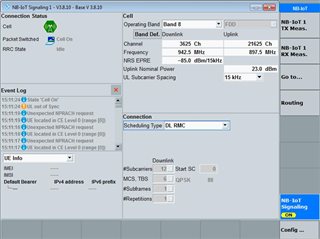

I would use the test nRF9160DK and Thing91DK with CMW500 equipment under NB-IOT stanadard.
Both DK kit and Thing91DK can connected to service provider when I plug-in service provider SIM card and cloud service seem to be normal

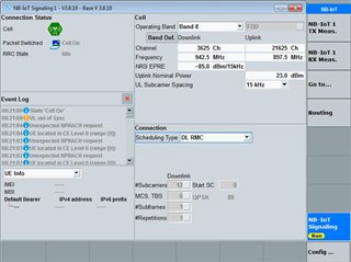

When I change the SIM card to R&S Test SIM with Thing91DK and using coaxial cable to connect to the kit with CMW500 and setup with corrected channel.  CMW500 can established connection with DUT (Thing91DK) as follows:
However, when it is running continuously, CMW500 will drop the connection as follows:
For it is using nRF9160DK instead of Thing91DK, it cannot make any successful connection all the time.
In addition, if I use another NB-IOT module with the same Test Sim card and same setup of CMW500, the connection is done all the time for both Tx and Rx measurement.
Please advise how to setup for making testing on it.
