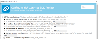

Hello
I am trying the UDP example, but I can't find the IP address and port number of transmission, also I would like know how to view the code of functions and libraries use in code to understand better the functioning.
Thanks in advance

In case you are using SES, you go to Project - Configure nRF Connect SDK Project... - menuconfig - UDP Sample Settings
There you can edit the server IP and port. Finally, press 'Configure' to apply the settings you made
By default, they are defined in the sample's Kconfig file as 8.8.8.8:2469.
You can change this by setting CONFIG_UDP_SERVER_ADDRESS_STATIC and CONFIG_UDP_SERVER_PORT in the prj.conf file.
If you build the sample with SES, you must re-open the project or use Project -> Run CMake for changes in prj.conf to take effect.
Or, you can use the configuration menu in SES directly, as explained by Christian Zingl.
