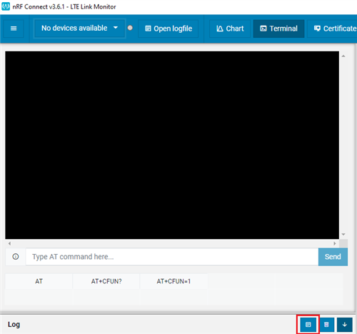

    I recommend reading the part about error handling in NCS in the nRF Connect SDK Tutorial There you can see that if CONFIG_NEWLIB_LIBC is set to "y", then you can find the error in the file \ncs\toolchain\opt\arm-none-eabi\sys\errno.h, and if it's set to "n", then the errno.h file in the C minimal library in Zephyr will be used. Since you get the error -116 I can see that it's the former errno.h file. There you can find that -116 is ETIMEDOUT, which means that the connection timed out. Were you able to establish a LTE-M or NB-IoT connection?
    Which version of NCS are you using? Could you provide a longer log of what is happening before the AT#XCONNECT command? If you're using the LTE Link Monitor you can open and then save the log by clicking the following button:
