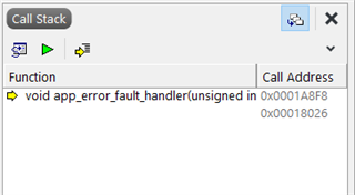

When the issue occured, then we are in __WEAK void app_error_fault_handler(uint32_t id, uint32_t pc, uint32_t info), with the following :
- id = 1  so this mean NRF_FAULT_ID_SD_ASSERT : NRF_LOG_ERROR("SOFTDEVICE: ASSERTION FAILED");
- pc = 0x00012976 ==> seems in soft device part
- info : 0

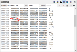

hereunder the stack :
the word 0xCAFEBABE seems to be a magic number to maybe help you to debug critical issue?
the callstack is not really help me :

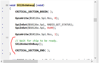

  • one more things,
    I've done another test :
    seems like we were in a critical section and then after this the hardfault happens :
    C630 is the new pointer issue
    0x27F6d is critical section ends
    What do you think about this? could it be the root cause ? Waiting for sx126 wakeup in critical section, quite long, then a soft device interrupt occurred too much time and then escalates an hardfault?
    Yes, that seems likely. You mentioned that you are advertising when this happens. You could e.g. stop the BLE advertising before you call SX126xWakeup(), then start the advertising again when SX126xWakeup() is done. Another option could be to make this SX126xWakeup()/SX126xWaitOnBusy() interrupt driven instead, i.e. trigger a GPIO interrupt when the chip is ready.
