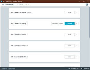

nRF Connect v3.6.1 Toolchain Manager will not allow me to add hardware
I browsed the Infocenter and found 'lots' of information and the instruction to install nRF Connect so I did. I hadn't decided which DK I needed to do what I wanted so when NCS asked I skipped the hardware. I now have NCS installed off the root of D:\ncs but when I tried to add the nRF52840-Dongle (I have that hardware) there doesn't appear be any instructions on adding hardware.  I installed nRF Connect SDK v1.142 which is the version that will work with Verizon firmware for the nRF9160 but where is the nRF52840 SDK? I downloaded the nRF52840 SDK but what do I do with it? How do I add Hardware?

     Can you please share what guide you used to install nRF Connect SDK? I'm not sure I understand how you skipped the hardware, as this is always included in nRF Connect SDK
    Have you seen the documentation for nRF Connect SDK? It includes several User Guides, including working with nRF52.
     Yes, this is correct. nRF Connect SDK v1.4.2 and modem FW v1.1.4 is currently certified to use on the Verizon Network.
     I'm not sure what you mean with nRF52840 SDK, do you mean the nRF5 SDK? There are currently two SDK that we support; nRF5 SDK, our stable SDK for nRF52 and nRF51 devices, and the nRF Connect SDK which is currently focused on nRF91-series and nRF53-series but does support nRF52 devices as well. Please see User Guide in the link above.

    After compiling several examples I wondered why I couldn't edit the *.c files, I clicked the No Editor ICON in the bottom right corner and my browser started downloading SES from the internet. I saved it but now what? Why did I apply for a license then have to download a new compiler?
  • Thank you for providing this information.
    The Toolchain Manager provides a sandbox solution which is easy to install for customers. It includes everything you need to start with NCS, including Segger Embedded Studio - Nordic Edition 5.10d. No devices are selected by the Toolchain Manager app, this is correct as it installs the nRF Connect SDK for you which includes supported devices.
     Please note that when choosing a project within SES, you need to be aware of what sample you choose and what device is supported. There are samples in the Zephyr repository, and there are samples in the nRF repository. Please make sure to read the sample documentation.
    Also, when working with the nRF52840 Dongle, please read its board documentation here.
