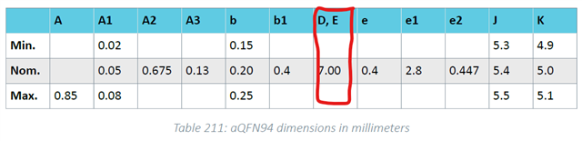

Could you help to advise what is the tolerance of dimension D, E (min/max) of 5340-QKAA (aQFN)?

The dimension given should be reliable, how accurately do you need it to be ?

hi Jonathan,
We have the normal value of D/E, but What is the max/min value of D/E?

Take look at this case for detailed answer: Nordic DevZone (nordicsemi.com)
Approximate tolerance of +/ 0.10mm.
