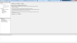

nrfgo stdudio nRF5x Programming is always gray.The version I installed is 1.21.2.10 for 64.
This problem is very strange.
First,I install the software(nrfgo studio,nrfgo studio-win64-1212installer.msi) on the company computer,the colour of nRF5x Programming is gray,not to be selected.But after I installed the Setup_JLink_V512g.exe,the nRF5x Programming is ok.It is able to connect my board.
But an interesting thing happened.When I got home,I tested it the same way on my laptop computer.And it's not working.NRF5x Programming is always gray.I'll try a different version
(nrfgostudio_win-64_1.15.1_installer.msi).It is ok.The latest version doesn't work.
My board is ok.Because I can use it after I download the routine.
The problem in the end where?I want to use the latest version of the program,Because the latest version can not fill in SoftDevice size.
