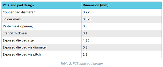

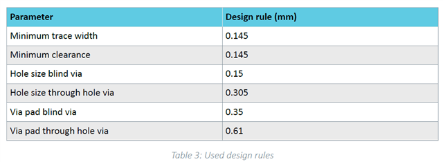

The recommended PCB layout of nRF5340
Hi Sir,
As we know the nRF5340 doesn't release the Circuit Board Guidelines (nAN-40) like nRF52840 yet.
If we need to design the nRF5340, could you share the recommended PCB layout (or PCB land pad design) of nRF5340 for board design first?
Thank you.
