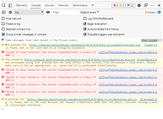

I figured out that I could use Microsoft Edge (chromium) Developer Tools to get some more information.
I logged in again and I kept getting this message:
I clicked on the link and it loaded this in a new tab:
I think this is because maybe my API key had expired. In the Account settings under Device API management it mentions that an API key expires after 60 minutes. I generated a new API key. I then refreshed the page to see what would happen in the console window.
There is still a 400 error code generated when it first loads and more are created when I click on the buttons. It says the 400 code means that it failed to load a resource.
I looked up the 400 error and I found a webpage that told me to try deleting cookies, flushing my DNS server, and clearing my browsers cache. I tried all of those things and it still does not work. Please help me.
