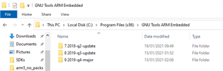

    Do you have arm-none-eabi-gcc installed? If so, what version? You can have several versions. Whenever I download a new SDK, I always also download the correct arm-none-eabi-gcc version that corresponds to that SDK version. As you see, it is looking for the 7-2018-q2-update version, which you can find here. (all versions for Windows, Mac and Linux. Please download the version that you are missing, and put it in the same folder as you have your current version.
    My versions are located here:
    Edvin
