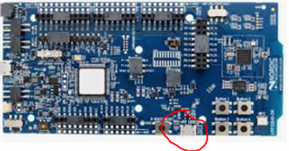

Please note I am using the correct port (the one on the side), Serial comms is working OK its just that all boards appear as the same number when connected.

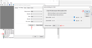

    Windows should enumerate the different COM devices to different COM ports, so if it doesn't, I guess you have to look this up in a Windows forum.
    I found a couple of links that you can look into:
    https://superuser.com/questions/1587613/windows-10-two-serial-usb-devices-were-given-an-identical-port-number
    https://www.rbdinstruments.com/blog/resolving-usb-conflicts-with-virtual-com-ports/
    Try to change the com port manually using Device Manager, right click the device you want to change, select properties, go to the port settings tab, select "Advanced", change the COM port Number, click OK:

  • We use the USB port on the long side of the NRF52840 dev board:
    The settings for this port are done programmatically within the application using the API

    If this Comm Port belongs to the programming chip why are there API's in the SDK to control the Com Port?
    Our intention was to eventually use application on the smaller Dongle without the Debugger, The Com port appearing when the dongle (below) is connected.
     No, sorry. I assumed you meant the other USB port. This is the nRF's USB peripheral COM port.

    The reason I brought up the windows links in the first reply was that at one point my home computer also got the same COM port on two different programmer chip USB ports (two different DKs), but I changed one of them, and then it was fine.
