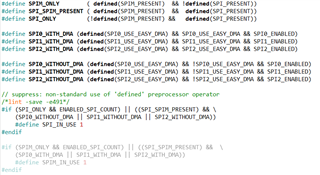

Note: I think, based on the below screenshot, that I am using SPI and not SPIM.
