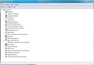

Wireshark doesn't recognize the dongle.  I tried to install the driver:  nrfconnect_cdc_acm.inf but won't install.  The PID for the dongle fw does not match this driver.  Is there a Windows 7 driver for a VID_1915 and PID_154A?

  • Can you check if this case which has the added entry for the Windows 7 driver helps. It appears that for some weird reason Nordic chose not to add the Win 7 driver support.
  • I took a look at that case.  I am not using the dongle as a BLE sniffer but using as a zigbee sniffer.  I am using the correct hex file but no windows driver for it.  The instructions above was originally for Windows 10 which has a driver for the dongle to run with PID_154A.
    If there is a zigbee sniffer software that will make the dongle run with Wireshark on Windows 7...  I can flash that hex file.
  • Please post the dongle name and the version number on its sticker.
    The driver for the 802.15.4 sniffer should be installed as part of the nRF Connect Desktop and may have been installed only for Windows 10. (I thought that the 802.15.4 sniffer was shipped with Win 7 support in its inf, but i could be wrong)
    Final fallback:
    Can you do the same steps as the case has suggested for the Bluetooth sniffer. Get the inf file from the nRF5 SDK  ( examples\usb_drivers ) and edit it to match your USB VID, PID.
  • nRF52840-Dongle
    PCA10059  1.2.0
    If I reset the dongle then the nRF Connect Programmer will recognize the dongle via COM port.  Programming that hex file, nrf802154_sniffer_dongle.hex, changed the PID while the VID remained the same and then the dongle shows up as a USB device and not as a COM port.
    Those were the only instructions I found for Wireshark when I searched for zigbee on Wireshart website.  Yes I believe those instructions are for Windows 10.
    I will try using the Bluetooth sniffer but what does that get me?
  • Yes, once the dongle flashed with the 802154 sniffer firmware shows up as the USB device. Edit the inf file in the SDKs examples\usb_drivers folder so that it has the VID and PID of the 802154 sniffer as in the case, than  point the driver for the dongle to the inf and cat file in the . This should install the CDC driver for the dongle and expose the COM port for the 802154 sniffer.
    Hope this is clearer.
