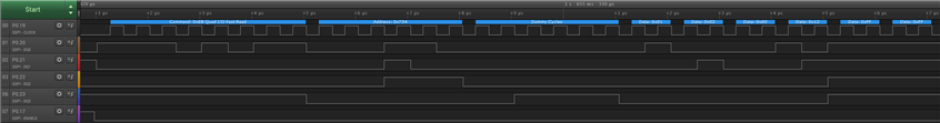

  • Looking further into this, I'm not sure that the flash chip is fully compatible with the QSPI interface, see this thread for some similar questions.
    I tested the XIP example in our SDK with the on-board flash chip on the nRF52840 DK, and I cannot find a matching instruction format in the datasheet you provided:
