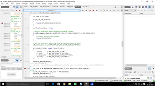

We have developed a PCB using nrf52840 controller. It's a brand new controller. I am using SEGGER embedded studio for programing.
I have flashed an example code ble_app_blinky_pca10056_s140 on the controller,.
This code isn't working on this controller. there is no problem in flashing the code but it's not working.
In above picture is the last location where code stops working.
This is mine main function

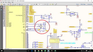

Is this happening because of soft devices?
Parents Reply
  • No. As I said, it is optional whether or not to use an LFXTAL when you are using our SoftDevice (Bluetooth stack).
    However, the SoftDevice does require an LFCLK. If you don't have an LFXTAL you need to tell the SoftDevice to use the RC Oscillator instead of the LFXTAL by setting the settings that I wrote in my first reply.
    Explanation:
    LFCLK: 32kHz clock.
    LFXTAL: a physical HardWare component generating the 32kHz frequency used by the LFCLK.
    RC Oscillator: An oscillator located inside the chip that can be used instead of an external LFXTAL.
