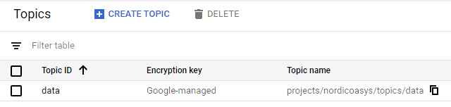

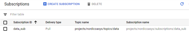

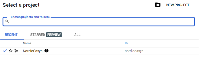

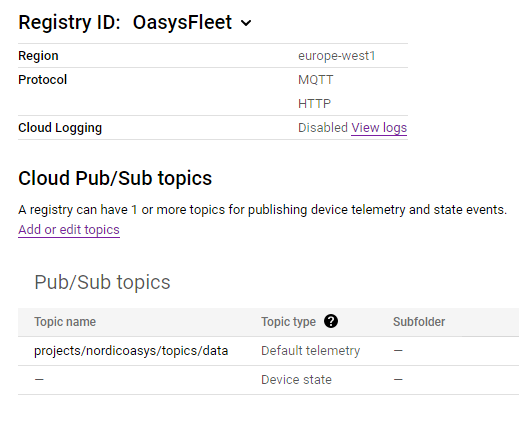

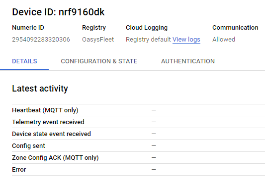

Google cloud setup:
- Project Info
- Registry Info
- Device info
- Pub/Sub     topic & subscription & member/role
