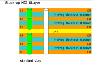

After number of (not so successful) attempts to route the PCB in 4 layers I gave up and switched to 2+2+2 HDI stackup. Anyway, via-in-pad option just set the price for the board, so it seem better to have clean and robust routing rather save a couple of coins per module.
The board thickness is 1 mm. It has four signal layers (two on the core, and two on the top and bottom lamination), and two ground planes; the layout looks as follows:
S G S - S G S
Here is the S is for signal, the G is for ground plane, and the dash is for the core. As I hope this provides good enough isolation as well as return path for high speed lines. Because of this assignment, the stackup requires stacked vias. At the same time, no buried vias were used. Microvia size is 0.1 drill / 0.3 cap. Tolerances 4 mil = 0.1 mm.

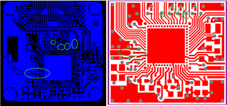

The very first question is about schematic. As it was mentioned above, the module intended to work from a 1.8-3.6V, and there's no need to power peripherals. I've shortened VDDH to the VDD and dropped DCCH. Please note, since the C6 became main input capacitor I've increased it to 4.7uF.
Regarding layout, I were managed to keep solid ground plane on the layers 2 and 5, but there is no separation between layers 3 (magenta) and 4 (red). I hope these layers will reference ground planes closest to them (and not cross planes), but could you please take a look?

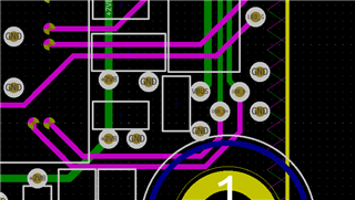

Another potential issue is the USB lines. They're started on layers 3 (magenta) and then jumped to 6 (green). To improve the signal conductance I provided number of GND through vias in closest proximity to each layer transition.
Next, there's the 96MHz QSPI. From my understanding, at this speed it's relatively safe to have 2 mm difference between longest / shortest line (lambda / 2 is about 1.5 m), but what do you say?
Finally, I'm not 100% sure about decoupling capacitors placement and routing. Could you comment on these too please?

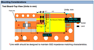

    4. I don't know what antenna your using, so if you want me to review that one, please upload the antenna datasheet.
    It's Johanson 2450AT07A0100. Please click on the link for the datasheet.

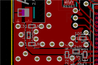

  • Hi Mishka,
    this look much better!
    Just duble check the dimensions for the antenna, you are a bit lower then the recommendations for some of the demotions.
    I would also change the placement of the pi-network for the antenna:
    or if you could move the antenna a bit more up, even more optimal would be like:
    Kaja
  • Hi Kaja,
    I've checked it, and as far as I can tell it looks correct. The datasheet drawing itself is not well made, perhaps this lost 0.1 mm is what you've noticed, or could you be more specific please?
    Moved it up and aligned the matching network as follows:
    The updated gerbers are also attached.
