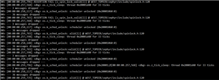

    I followed your suggestion and I see output on the RTT viewer but I'm not seeing the printk() messages.
    On the RTT viewer I see the following output:
    Can you kindly suggest what could be causing this and how to fix this?
    thank you.
  • Hi again!
    I suspect that the printk messages might be suppressed due to excessive logging. Could you try to remove CONFIG_LOG_DEFAULT_LEVEL=4 (so that DBG messages aren't shown) and see if helps? That's currently the only difference between my prj.conf and yours.
    Carl Richard
  • Hi Carl,
    It works perfectly now. Thanks for the help!
