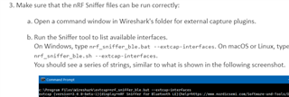

    Follow-on question.  We are getting all the software downloaded (as outlined in Nordic instructions for the BLE Sniffer) to program the 52840 DK for when it arrives and encountered an error with the steps for ensuring the nRF Sniffer files runs correctly with Wireshark.  Specifically, do we need to have the 52840 DK physically connected to our computer to ensure the Sniffer files run correctly?  We get an error stating "serial not found" when we do the below but again we don't have the DK just yet.
  • I do not think that support for coded PHY is available in the nRF Sniffer. You do need the COM port which the nRF52840-DK exposes to get this to work correctly.
