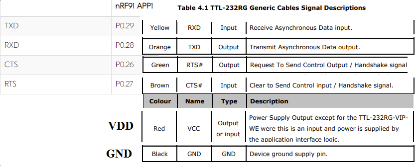

    B- to communicate with the modem with AT command, I will use UART0 like here interfacing with UART0

    1- Which serial interface can I use to update the modem firmware through MCUBoot and mcumgr (without adapters J-LINK)? The same interface UART0 like this
    or anther interface UART1
    2-  it is possible to send At-Command with the same serial interface and update firmware (for example UART0)

  • Hi!
    Sounds good. For your application I suggest that you look into the serial lte modem sample application which implements a serial AT-command interface in addition to using the MCUBoot bootloader.  In addition, just to clarify: to flash and debug the nRF9160 externally you need a J-Link debugger, like the one you link to or like the one on the nRF9160 DK. Then to your questions.
    1. You must use one of the UART interfaces. The specific UART used by mcumgr can be configured using CONFIG_UART_MCUMGR_ON_DEV_NAME.
    2. I will need to check this with the developers. I'll come back to you within Friday.

  • Hi!
    Got from a colleague that it's theoretically possible to use the same UART for AT-commands and serial firmware updates we would recommend against it.
