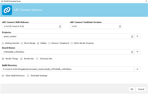

I've also tried to build and run an example program in the segger embedded studio IDE (I've updated the modem firmware to the latest using the programmer tool and I'm using nrf connect sdk version 1.4.0, should I be using a newer one?) and even the example programs fail, getting the following terminal output:

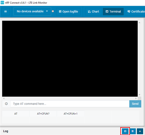

    Could you please download the LTE Link Monitor application in nRF Connect for Desktop and open your nRF9160 DK there? It should print the log from the device, as well as show you the status of the modem and LTE connection in the upper right corner.

    The LTE link Monitor was another thing that was giving me issues. I've tried using it previously to see if it could provide any insight into what was wrong however
     - the modem status says power off
     - the terminal has nothing printed out to it even after I try to reset the device via the onboard reset button
     - all of the preset command buttons (ie AT, AT+CFUN?, etc. return a timed out error in the log.

    If you install it with the Toolchain Manager on Windows 10 it should work out of the box. How did you open SES (SEGGER Embedded Studio)? When you install it with the Toolchain Manager you have to open it there as well, using the "Open IDE" button.
    Could you open the Asset Tracker application in SES and try to build it? Please make sure to select the correct configurations when you open the project, such as the board name, which should be nrf9160dk_nrf9160ns. If you're able to build it, please flash it to your board and see whether this affects anything.
    You already mention that you've updated the modem firmware, and I assume you updated it to v1.2.3. NCS v1.4.0 has been tested with modem firmware v1.2.2, as you can see here, but it should work with v1.2.3 as well. You could also update to NCS v1.4.2, which has been tested with modem firmware v1.2.3.

  • I've been opening SES through the toolchain manager via the Open IDE button.
    I've been using v1.2.3 for the modem firmware however just tried updating the board with v1.2.2 to see if it would make a difference. When trying to build the asset tracker application the build still fails with the following terminal output

    This might be a problem with the path length, as I've seen several cases where a too long path might cause problems in Windows. I would recommend reinstalling the SDK under C:/ncs/ instead. You can change the default installation directory in the settings in Toolchain Manager, or you can choose another directory when installing. As I mentioned before, installing it with the Toolchain Manager should install all necessary tools, so you shouldn't be missing any. Another thing you can try is to update the toolchain by pressing the arrow facing down next to "Open IDE" and selecting "Update toolchain". Another option is to install the SDK manually. This does however require more work, but it's an option if you run into problems during the installation using Toolchain Manager, or for those who prefer to install it manually. I would recommend first trying the two Toolchain Manager options I mentioned, installing it in another location and updating toolchain, before installing it manually.
    Since the modem says powered off in LTE Link Monitor and the terminal window doesn't print any logs, it's hard to say why you're unable to connect. With both Asset Tracker, which is what new nRF9160 DKs are programmed with, and AT Client, you should get some logs when the device starts up.
    Since you're having problems building applications in SES, I have created some precompiled firmware images you can try to program to your device, so we can try to figure out why you're unable to connect to nRF Cloud. You can program them with the Programmer application in nRF Connect for Desktop. I've attached the AT Client sample and Asset Tracker application. Both of them are from v1.4.0 of NCS since that's what you said you've been using. If you want another version of NCS, please let me know and I'll share that as well.

    If you're able to program these to your device and get logs in LTE Link Monitor, please share the logs. You can download the log file from LTE Link Monitor by clicking the "Open log file" button.
    Marte
  • The precompiled firmware images you sent work perfectly and I'm able to connect to the cloud and see current data perfectly which seems weird as the LTE Link monitor is showing the same status values in the upper right corner of the UI. I've also attached the log file from the LTE Link monitor below as requested.
    I've attached the log file from the LTE Link monitor below

    The issues still persist with the IDE not building any sample applications without failing even after trying different IDE versions and shortening the path length to C:/ncs/.
    Although IDE version 1.5.0 seems to make it much farther in the build process before failing than the other IDEs it still ends up failing.

    Great to hear that you're able to connect to cloud and send data, then we know that your nRF9160 DK works as expected and that there are no problems connecting to the network.
    The reason LTE Link Monitor shows modem off might be because there hasn't been sent any AT commands to the modem yet. I'm sorry if my previous replies has been confusing regarding this, but LTE Link Monitor doesn't know the status of the modem unless the device has tried to communicate with it, so if there hasn't been sent any AT commands after you connected to the nRF9160 DK in LTE Link Monitor, then the program won't know the status of the modem. You can get the current functional mode of the modem with AT+CFUN?. This should return +CFUN: 1 if the modem is in normal mode, and this will also let LTE Link Monitor know the status of the modem. You should have Automatic requests turned on for this (can be found in the lower right of the LTE Link Monitor).
    I've tried to reproduce the issue you're experiencing when building, but so far I've been unable to do so. What are you selecting as toolchain version when you open the projects? Have you made any changes to the installation? Could you check what the environment variables are set to in SES? You can do this by going to Tools > Options > nRF Connect. Since you installed NCS with Toolchain Manager, you should have the following:
    GNU ARM Embedded Toolchain Directory = C:\ncs\<ncs_version>\toolchain\opt
    Zephyr Base = C:\ncs\<ncs_version>\zephyr
    Also let me know if any of the other fields are something other than None.

    Apologies for not responding sooner, it turns out the issue was that SES needed administrative access to run the cmd commands. opening the nRFconnect app as administrator fixed my issues
