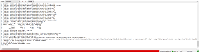

Hey anyone,
Going through the 'getting started' process for the nRF 9160 DK I'm having some issues.
I've followed the steps to install nRF connect etc. suggested in the nordic documentation as well as followed along in the unboxing instructional video provided by nordic (https://www.youtube.com/watch?v=rMvW3HXLErk).
However when I try to test the 'asset tracker' application to verify the LTE/GPS functionality it doesn't seem to work and I'm running into the following issue:
 - The reset button appears to have no impact when it is pressed
 - LED 3 and LED 4 never light up to indicate any action regarding the LTE connection process
 - I'm thus unable to add my device in the nRF cloud solution
I've also tried to build and run an example program in the segger embedded studio IDE (I've updated the modem firmware to the latest using the programmer tool and I'm using nrf connect sdk version 1.4.0, should I be using a newer one?) and even the example programs fail, getting the following terminal output:
Im extremely new to nordic devices and the nRF SDK etc. so any help is greatly appreciated!
  • The precompiled firmware images you sent work perfectly and I'm able to connect to the cloud and see current data perfectly which seems weird as the LTE Link monitor is showing the same status values in the upper right corner of the UI. I've also attached the log file from the LTE Link monitor below as requested.
    I've attached the log file from the LTE Link monitor below
    However,
    The issues still persist with the IDE not building any sample applications without failing even after trying different IDE versions and shortening the path length to C:/ncs/.
    Although IDE version 1.5.0 seems to make it much farther in the build process before failing than the other IDEs it still ends up failing.
    Here is the log file from the LTE Link monitor while flashed with the asset_tracker image:

    Great to hear that you're able to connect to cloud and send data, then we know that your nRF9160 DK works as expected and that there are no problems connecting to the network.
    The reason LTE Link Monitor shows modem off might be because there hasn't been sent any AT commands to the modem yet. I'm sorry if my previous replies has been confusing regarding this, but LTE Link Monitor doesn't know the status of the modem unless the device has tried to communicate with it, so if there hasn't been sent any AT commands after you connected to the nRF9160 DK in LTE Link Monitor, then the program won't know the status of the modem. You can get the current functional mode of the modem with AT+CFUN?. This should return +CFUN: 1 if the modem is in normal mode, and this will also let LTE Link Monitor know the status of the modem. You should have Automatic requests turned on for this (can be found in the lower right of the LTE Link Monitor).
    I've tried to reproduce the issue you're experiencing when building, but so far I've been unable to do so. What are you selecting as toolchain version when you open the projects? Have you made any changes to the installation? Could you check what the environment variables are set to in SES? You can do this by going to Tools > Options > nRF Connect. Since you installed NCS with Toolchain Manager, you should have the following:
    GNU ARM Embedded Toolchain Directory = C:\ncs\<ncs_version>\toolchain\opt
    Zephyr Base = C:\ncs\<ncs_version>\zephyr
    Also let me know if any of the other fields are something other than None.
    Marte
  • Marte,
    Apologies for not responding sooner, it turns out the issue was that SES needed administrative access to run the cmd commands. opening the nRFconnect app as administrator fixed my issues
