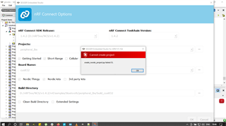

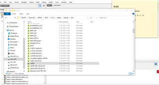

  • Hi
    Please check out this case which describes how to create a custom board file in the NCS/Zephyr/boards. The error you're seeing is likely caused by trying to open the project for a not supported board, and if so you need to add the board to the directory yourself.
    Simon

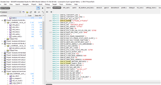

  • Hi Simonr,
       I have done changes in board.cmake file
    board_runner_args(nrfjprog "--nrf-family=NRF52")
    board_runner_args(jlink "--device=nrf52" "--speed=4000")
    board_runner_args(pyocd "--target=nrf52" "--frequency=4000000")
    include(${ZEPHYR_BASE}/boards/common/nrfjprog.board.cmake)
    include(${ZEPHYR_BASE}/boards/common/jlink.board.cmake)
    include(${ZEPHYR_BASE}/boards/common/pyocd.board.cmake)
    Previously it was
    include(${ZEPHYR_BASE}/boards/common/openocd-nrf5.board.cmake)
    only deleting this line
    NCS project is getting created and Build
    is this the correct one ?
    Is that need to create SOC folder for custom boards ?

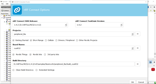

  • Hi Simon,
      Is it possible to change the multiple boards in the NCS project file
    like i have created the NCS project file nrf52dk_nrf52832
    and also i have created a custom board BC832
    but i can't able to change the boards as like nrf5 SDK in NCS
    How to change the multiple board configuration in the same build project file?
