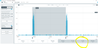

After the last update:
On this chart, the real period == 20 seconds, not 10 as on the chart.
PPK2 shows time == time / 2

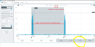

the selected gray area is actually 20 seconds!
I'm not able to replicate this timing discrepancy on my intel PC, but I found some other reports suggesting it may be a problem with some AMD systems. Would you mind creating a system report for you PC and post here?
Do you have another PC you can try this on? I'm still not able to replicat this on my work computer.
There is no problem on the Intel system. Everything is displayed correctly.
