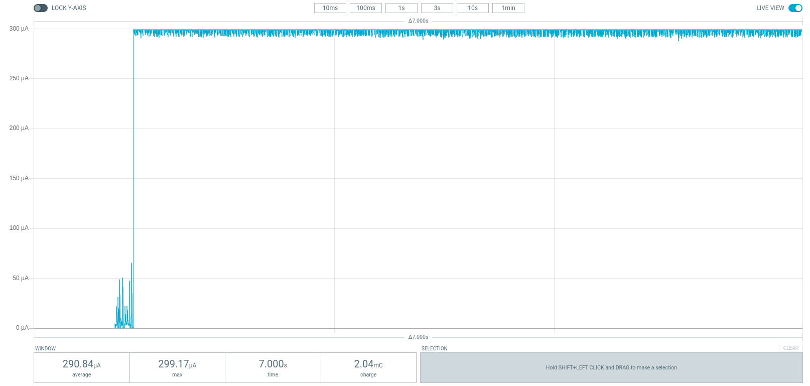

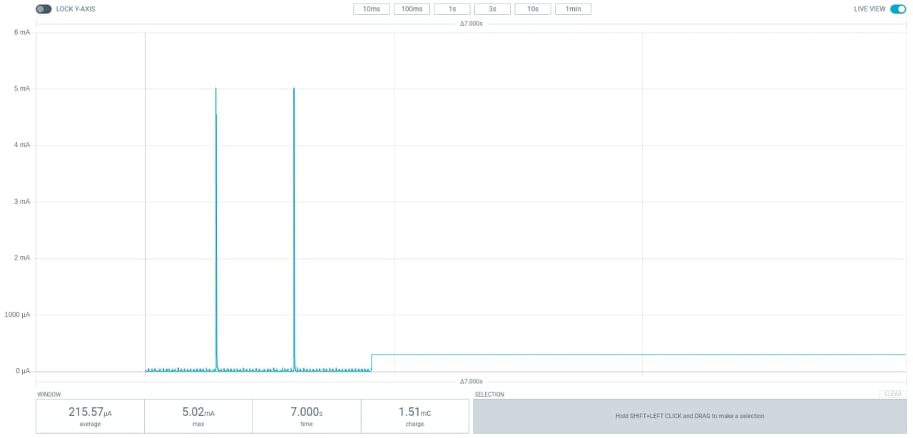

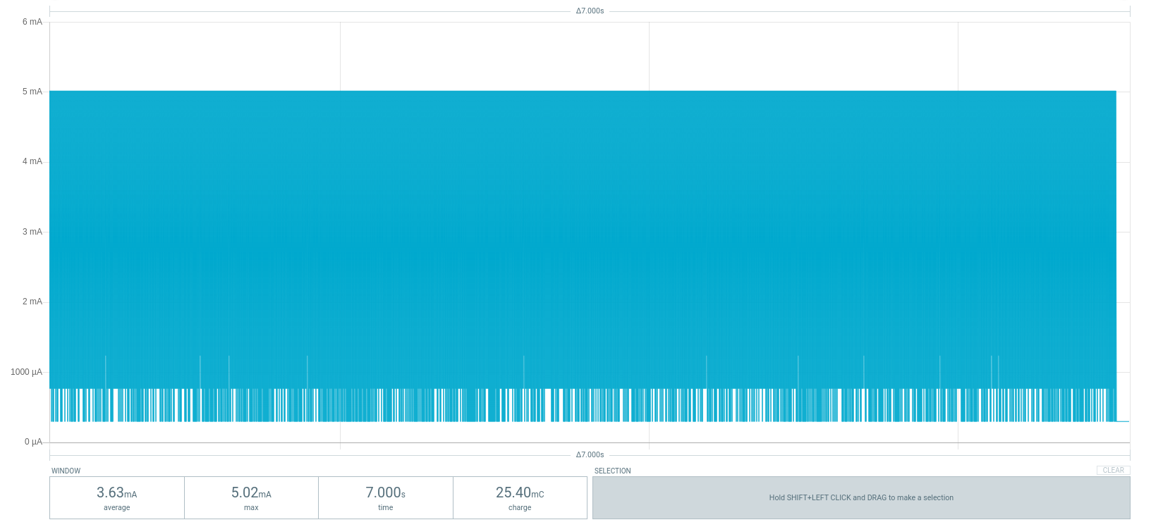

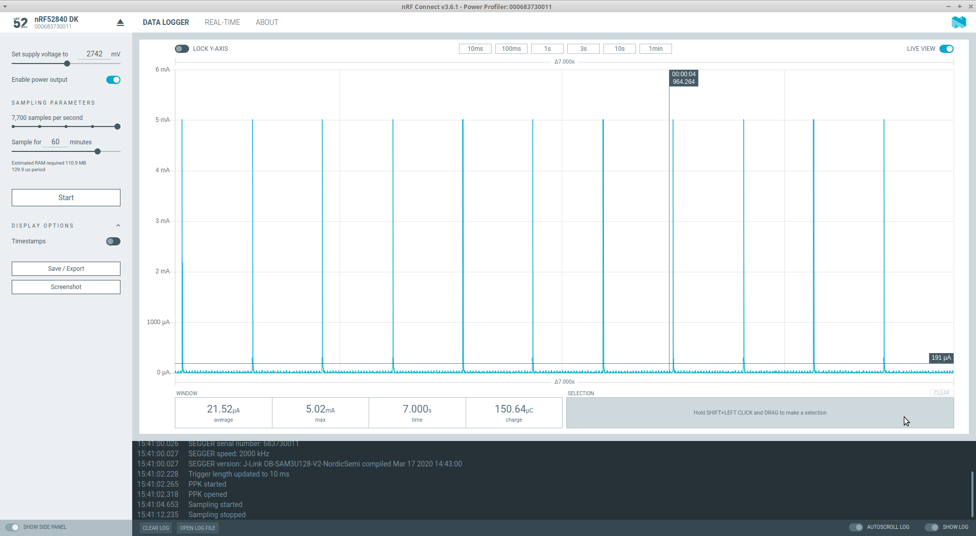

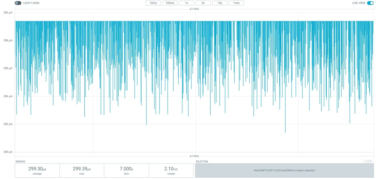

Noise from power profiler analysis
I've got several problems but they are all linked more or less with the power profiler.

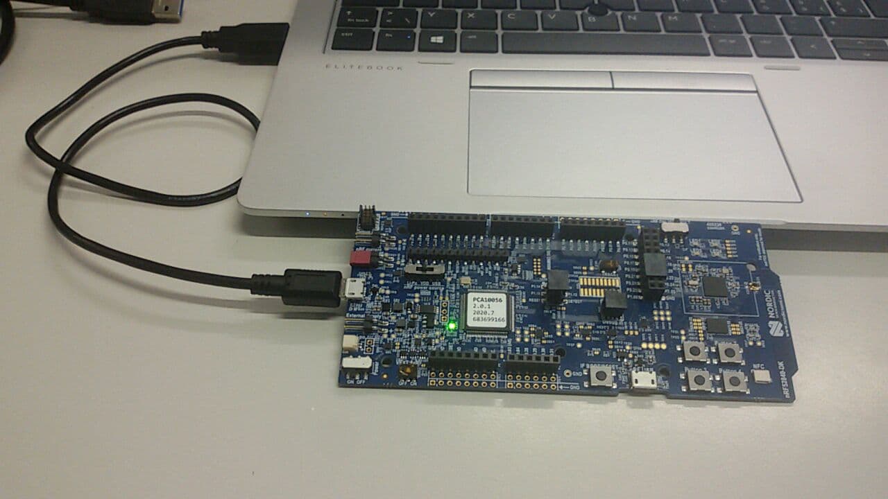

All devices I have are nRF52840 dk. The code is written with Zephyr but I doubt it plays a big role. For power profiler, we have the power profiler kit.

2nd problem : I tried to use another nRF52840 with the power profiler. I cut the SB40. The problem is that I seem to get wrong measurements. I'm flashing a simple beacon app to test so I'm expecting to get high value from time to time (beacon being send), otherwise low power consumption. Sometimes, the beginning is okey, but then I just have a straight line, and sometimes I seem to get only noise. Why ? The configuration of the power profiler is as follow :
- SW2 on DK
- SW4 on DK
- COM on DK
The jumper is removed when measuring. I removed the USB hub as well. I'm connecting the nRF52840 with an USB cable directly to the computer.
If I test with the device that I can't flash anymore, it's working perfectly, I have the beacon power consumption.
3rd problem : I tried to measure the power consumption of the sparkfun nRF52840 Mini as DUT and using the power profiler. When measuring the beacon app, everything is working great, so I'm able to set up everything correctly. But then measuring a mesh network application, I only see a blue square, or a straight line. Why is that ?
    It is a bit interesting that you get seemingly correct measurements with the other DK, which you have issue programming. Could it be that you accidentally programed the nRF on the DK (which is the DUT here?) with the PPK firmware? That will not have the current consumption pattern you expect to see.
    You are covering 7 seconds here, so if there is a lot changes in current consumption that would be squashed together and look like a big blue square. It would not be possible to read anything from this plot. I suggest you look at a much smaller time window.

    2nd problem :
    Well, here is the procedure I followed :
    • Remove the power profiler from any nRF
    • Setup the jumper on the nRF with cut SB40
    • Flash the beacon program, verify with nRF connect App that we really have a beacon device
    • Turn off the nRF, setup the power profiler on the nRF, remove the jumper, turn on
    • Open the Power Profiler app, select device. It doesn't ask to flash so I suppose it's ok ?
    • The first result was this, then I closed and reopened the Power profiler app and had only noise like the image in the original post.
    For the sake of the experiment, I tried to setup the power profiler on the nRF that I can't flash again. I have the right Power Profiler output.
    3rd problem :
    Yes you are right but if I zoom in, I just have line going from down to up, there is no sense. And this blue square would be followed by a straight line.
