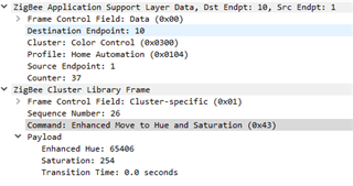

I'm currently developing the code of a RGB led lamp. The thing is, when I change the color while sniffing with Wireshark, I see only 1 payload (the way it should be), but I get two callbacks at zcl_device_cb with the ZB_ZCL_ATTR_COLOR_CONTROL_ENHANCED_CURRENT_HUE_ID instead of one.

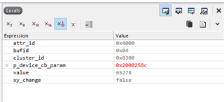

The first callback it's random info (the value parameter), I don't know why is there and that's why I'm trying to understand.

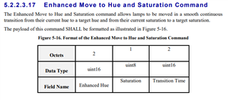

The second callback contains the actual info (value parameter), but only half of it. The only info I can get is the Enhanced HUE value, but the saturation nor the transition time.
As you can see in the ZCL specification, saturation and transition time should be also there.
Wireshark screenshot:

    "I think that there is some misunderstanding in this issue.
    The ZCL callback is used by the stack to inform the user application about the value of an attribute that has changed. For commands with non-zero transition time, the transition from the initial attribute value to the value set by the command needs to be achieved incrementally, in steps, in time set by transition time. This is handled by the stack and simplifies the user application. ZCL callbacks are being called on each attribute value that is being changed.
    Look at the light bulb example: When it receives a Move to Level command, it does not handle the transition time directly. The bulb is informed by the stack about a new value of an attribute to set the on-board LED to the correct brightness. Try sending a Move to Level command with transition time set to 3 seconds, and you should see the LED brightness slowly increasing/decreasing.
    In your case, you can see two ZCL callbacks being called, both for the same attribute. This is the transition to the attribute's final value as received in the command. There is no ZCL callback for the saturation attribute and most probably the saturation value was already the same value as set by the command.
    When it comes to the ZB_ZCL_SET_ATTRIBUTE(), it calls the zb_zcl_set_attr_val() function. It is used to perform additional checks before the value is written to an attribute. It also informs the stack that the value of an attribute is changed. The multisensor example measures the temperature and the corresponding attribute value is being updated. When using the functions to set the attribute's value, the stack is informed about this change and can perform additional actions if required (e.g. send reporting).
    The default response packet is sent in response if requested by the ZCL command. If not either the status contains an error or no command is sent in response to the received command. The ZCL Frame Control Field has a bit "Disable Default Response" which informs the device receiving the packet if the Default Response must be sent. In your ZCL callback, is the status of the Default Response command set to true or false? And what is the status (return code)?"
