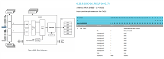

I searched in the microcontroller datasheet and on Nordic dev zone; I found that even if the 8 channels of the ADC are used, we can use the VDDH pin of the µC (capture diagram_block)
My concern is how I can set the reference voltage? Can I connect VDDH directly to the battery and do I need to add elements like resistors or capacitors?

    Ah, then it seems I have misunderstood your last question.
    A SAADC channel can be connected directly to the VDDH internally, through setting the channels PSEL to 0x0D, no external circuitry needed.
    Same goes for the VDD bus.
    Could you confirm for me which power supply configuration you are using for your device? And that by state, you mean to ask about the voltage level presumably connected to the VDDH pin of the nRF52840?

    From your schematic it seems that you will operate in Normal Voltage Mode - since you have shorted VDD and VDDH - which means that the VDD supply must never exceed 3.6V.

    Thank you for providing this. From the datasheet it states that the normal voltage of the battery is 3.7 V, which means you will have to use high voltage operating mode.

    Yes, please see the reference circuitry schematics for the nRF52840.
    Your decoupling should match that of the reference circuitry, for optimal performance.
    If you are using TXPOWER less than +5 dbm it is configuration 4 of the reference circuitry that seems like the correct configuration for your application. Since you intend to use a battery voltage corresponding high voltage mode, you will also have to change your VDD/VDDH connection in the diagram screenshot you attached.
