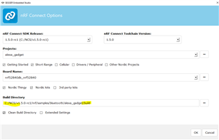

After having development success with the nRF52840 I'm beginning to look at development on the newer nRF5340. I've successfully gotten the blinky example working on the development kit, but am running into issues with the alexa_gadget example, which I'm unable to compile successfully in Segger (v5.34a); I'm on a Windows 64bit machine, using NCS 1.5.0-rc1, and on the nRF5340 DK. When opening nRF Connect SDK project, the board name I'm loading this project on is: nrf5340dk_nrf5340_cpuapp (which I'm assuming is the right one for this dev kit?)

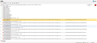

Here is a screenshot of the full set of compiler errors, which all relate to a similar dependency error:
