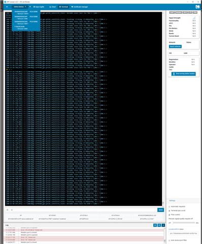

  • Hi Ian,
    Yano said:
    I've scoped it and I can confirm LTE link monitor is not sending commands but Tera Term is?!
    Yano said:
    First of all I've moved to a Prolific USB/UART bridge instead of the FTDI one (for now) but it was the same with that bridge.
    It is very good to hear that the usb/uart adapters themselves work with various other terminal programs.
     I have created a bug internally on this matter. based on the test procedure that you have gone through, everything points to the LTE Link Monitor not properly handling sending data from the PC -> USB/UART adapter.
    The best option as of now, is to use a generic terminal application to issue the specific AT commands required by the test house (usually AT%XRFTEST, and maybe a test to connect to a network via AT+CFUN=1).
    Please let me know if you run into any issues with the testing procedure.
    Håkon

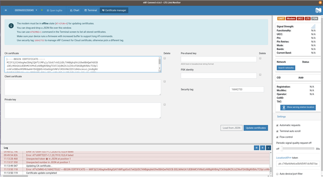

  • Hi Håkon,
    I think I'm OK for the RED testing (now starting Monday) but I also need to get certs into our hardware.
    Is there a way to do this using a standard serial terminal?
    Could we use USB bridge on an nRF9160-DK and wire it to our hardware and if so what way could we wire it, we have not problem modifying one (cutting tracks etc.).
    Also is there a document on the pin re-assignment process (.overlay etc) we had to do? I would like to fully understand the script used.
    Thanks
    Ian

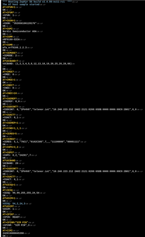

  • Hi Ian,
    I think you are over-thinking what LTE Link Monitor provides. I agree that it is helpful for the automatic response attach after issuing AT+CFUN=1, but most of this is not strictly required when going 3GPP testing, as such tests are usually carried out from the LTE tester point of view. Any RF PHY evaluating specific command isn't parsed in LTE LinkMonitor either.
    LTE Link Monitor is a terminal, similar to teraterm/realterm/putty, that can parse specific AT command response. There's strictly no need to use it, but it helps  wrt. what it "automatically" issues if you have "automatic requests" enabled, and issue a "AT+CFUN?" and parse the information provided by the different AT commands (your IP, RSRP, network status).
    For issuing AT%XRFTEST, the LTE Link Monitor does not give you any parsed output, expect color highlighting.
    If you are interested in the sequence that it provides when doing automatic requests, here's an example of that:

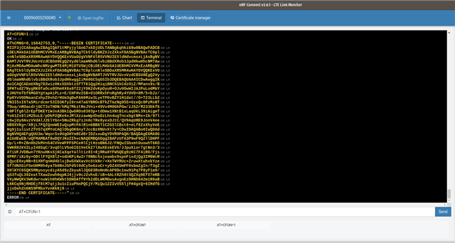

  • Hi Ian,
    My deepest apologies for the behavior you're seeing here. It is not yet fixed in nRF connect for desktop.
    In firmware, you can use the API "modem_key_mgmt_write" to write certificates, similar to how it is done in the aws_fota sample:
    https://developer.nordicsemi.com/nRF_Connect_SDK/doc/latest/nrf/samples/nrf9160/aws_fota/README.html#updating-the-certificates
    Writing the certificate in firmware require that you put the certificate into "C format".
