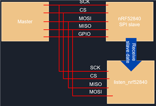

Use another nrf52840 to eavesdrop on the master and slave communicating with SPI
My stm32 (as a master) uses SPI to communicate with nrf52840 (as a slave)
When my nrf52840 wants to send data to stm32, it will pull a GPIO to let stm32 generate a GPIO interrupt to read the data transmitted by nrf52840
Now I want to use another listen_nrf52840 (as a sniffer) to receive the data transmitted by both of them in parallel.

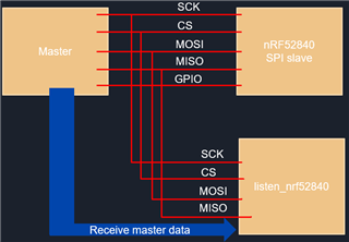

The SPI pin of my listen_nrf52840 is the same as the SPI slave, but it can only receive data from the master, as shown below
However, when I swap the MOSI and MISO pins of listen_nrf52840, I can receive the data sent by the SPI slave.
As shown below
Kind of like what a logic analyzer is doing
Can I change the pin number of listen_nrf52840 during operation?
Or is there any way for the SPI slave to receive data from another SPI slave and master at the same time ?

    I don't know whether you intend to create this as part of a larger application, or if you intend to just create an SPI sniffer. Either way, there is a few challenges that needs some attention.
    The MISO line in an SPI peripheral is an output pin (when the nRF is not the master). Assuming that the SPI is used for bidirectional communication (simultaneously), it would not be possible to connect the two lines together either. So you need two input pins, instead of one input and one output.
    The SPI doesn't support two inputs like this, unfortunately, so as I see it, you have two options:
    Either, you can bitbang the data lines. This is really not recommended, because it takes a lot of CPU capacity (you require severeal interrupts per byte). At least if you intend to do something else (such as Bluetooth Low Energy) at the same time, this will not work very well.
    The other option is to use two SPI instances at the same time, and use the MOSI pins for each of them. Connect one to the actuall SPI's MOSI, and the other one to the MISO. So basically, do what you already did, but use two SPI instances, and connect MOSI on each instance to MOSI and MISO on the actual SPI you want to sniff. I think this is your best shot. You have already done half of it.
