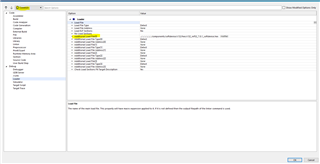

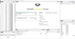

I messed up my SES project and now the debugging session doesn´t start and the debugger does some weird stuff and doesn´t execute my application.
I also tested if the error does exist in the example projects from Nordic and the problem doesn´t exist. So I think I have some issues in my project configuration.
    To see if it fixes the problem, please try to do a full chip erase, then re-program the applicaiton FW. From the screenshots it looks like the program is stuck at the beginning of flash, and probably not reaching your main() function.

  • Hello, I run "Target" -> "Erase all" and start a new debug session and this happens:
  • Sure you posted the correct image? It appears identical to the one I posted.

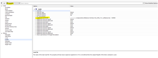

  • Yes. Please take a look at my project settings:

  • Thanks. So the Softdevice must be present with your current linker configuration. The start address must be changed to '0' if you want the application to run without the Softdevice.
    Note that you can use the Programmer app in nRF connect for desktop to see the memory laout.
  • Thank you. I wonder because I removed the BLE code a few weeks ago and now I have the problems. Strange, but it seems that the error is gone now. I will test it a few more times.
