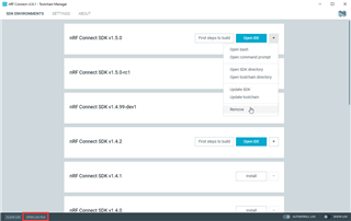

Checksum Validation Failed - While installing nRF Connect SDK 1.5.0 through Toolchain Manager
I am trying to compile a sample application for the Board nRF5240 . While i install the nRF Connect SDK for ncs v1.5.0 through Toolchain Manager 0.9.1 , I get the error as Checksum Verification failed , and it is struck on initializing environment.
My issue looks similar to this . Where in the installed folder i could only find the embedded studio and arm compiler , but not the zephyr and other modules.
What do you think would be the potential cause of this issue. I have tried to install other ncs v1.4.0 , 1.4.2 . I get the same error for these too.
My Windows OS is Win 10 - Version:10.0.18363 Build 18363.
    Could you remove your current SDK v1.5.0 installation (as shown in the picture below)?
    Thereafter, please re-install SDK v1.5.0. When finished, click on the “OPEN LOG FILE” button and provide me with the log of the installation.
    It should look like this:

    2021-03-03T14:32:31.671Z INFO Start to install toolchain v1.5.0
    2021-03-03T14:32:31.672Z INFO Installing ncs-toolchain-v1.5.0-20210225-607a0e0.zip at C:\Users\smohan\ncs\v1.5.0\toolchain
    2021-03-03T14:32:31.672Z DEBUG Install with toolchain version 20210225
    2021-03-03T14:32:31.672Z DEBUG Install with sha512 5781e7500271805e1595ebf3eb04e75b5bd1e0f204dcb29a7c172d2b388f1a9a62b0fd40483b6d529c4e0a6a2f138e040fabb5ca2e360a40256ccb87c573bdce
    2021-03-03T14:32:31.712Z INFO Downloading toolchain v1.5.0
    2021-03-03T14:35:12.625Z ERROR Checksum verification failed https://developer.nordicsemi.com/.pc-tools/toolchain/ncs-toolchain-v1.5.0-20210225-607a0e0.zip
    2021-03-03T14:35:12.635Z INFO Cloning nRF Connect SDK v1.5.0
    2021-03-03T14:35:12.648Z INFO Initializing environment for v1.5.0
  • solved this issue by giving admin access to nrf connect app, and also disabling ssl certification of git.
  • Good to hear that you could solve the issue. Thanks for the feedback!
