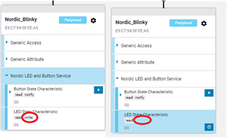

  • Oh. I see.
    So the add_char_params.char_props.write only indicates during service discovery what characteristics that can be read or written to (or enable notifications or indications). As you can see if you try to connect using nRF Connect for Desktop, the write button disappears when setting this to 0:
    But as you say, you will still be able to physically write to it using e.g. the ble_app_blinky_c example (so by forcing it).
    If you want to physically disallow writes (or reads), you need to change the parameter a few lines down:
        add_char_params.write_access = SEC_OPEN;
    to:
        add_char_params.write_access = SEC_NO_ACCESS;
    Or any other value defined in the enum security_req_t in ble_srv_common.h if you want to require encryption before reading.
    I can agree that this is a bit unintuitive, but hopefully, it solves your requirement.
    Edvin
